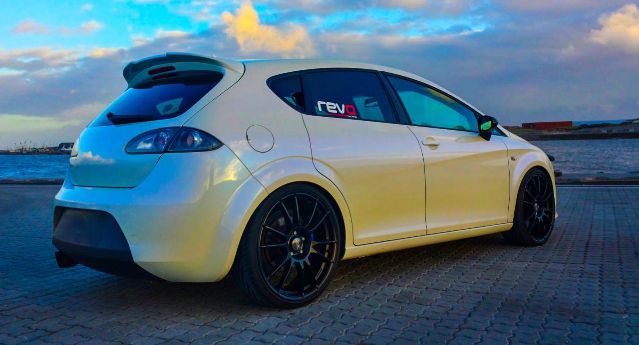

2007 Seat Leon Cupra RT500
Morten Cupra
- Indlæg: 7
- Tilmeldt: 30. okt 2010, 12:56
Bilfabrikant:Seat
Model:Cupra RT500
Motor/HK:
CTS Turbo kit for 2.0 TFSI:
- Garrett GTX3071R Turbocharger
- CTS 2.0T T3 Turbo Manifold
- 3" Stainless Steel downpipe
- Thermal heat wrap of downpipe and boost pipes
- Precision 39mm external wastegate
- Stainless steel braided oil feed line kit
- Stainless steel braided oil drain line kit
- Stainless Steel charge piping to intercooler system
- OEM style heat jacketing
- Diverter valve adapter kit
- Coolant line relocation kit
- Upgraded Coolant line and associated fittings
- Gaskets, nuts, studs, clamps, brackets
- Integrated Engineering connecting rods
- JE Pistons with special tool steel wristpins
- Calico Coated Race bearings
- ARP Top, Main and Rod bearings
- Bosch 044 650hp low pressure fuel pump.
- Upgrade High pressure fuel pump
- RS4 injectors
- Custom Sorensen Performance Air-intake with KN Filter
- Evolution Motorsports heat cover for turbo
- THS TFSI Intercooler
- Forge SuperSize Blowoff
- Revo Dogbone mount
- RS4 fuel pressure valve (130Bar)
- Southbend Stage5 Race TFSI Clutch
- Quaife Fast Road Limited slip Differential TFSI
- Revo TB Pipe & Methanol injection Kit with AEM injector.
- Custom Sorensen Performance Stage2 Intake Manifold
- 2,75" Miltek Exhaust
- Eboost2 Electronic Boost controller
-APR Højtryks benzinpumpe
-Evolution Motorsports heat cover for udstødnings manifold.
-2,75" Miltek udstødning resten af vejen
-Forge SuperSize Blowoff
-Forstærket gearkasse ophæng fra BSH
-RS4 Benzin Returtryks Ventil (130Bar)
- Revo Stage4 Race Software (at Sorensen-performance.dk)
Sidste måling jeg har udskrift på er:
520Hk og 640NM
