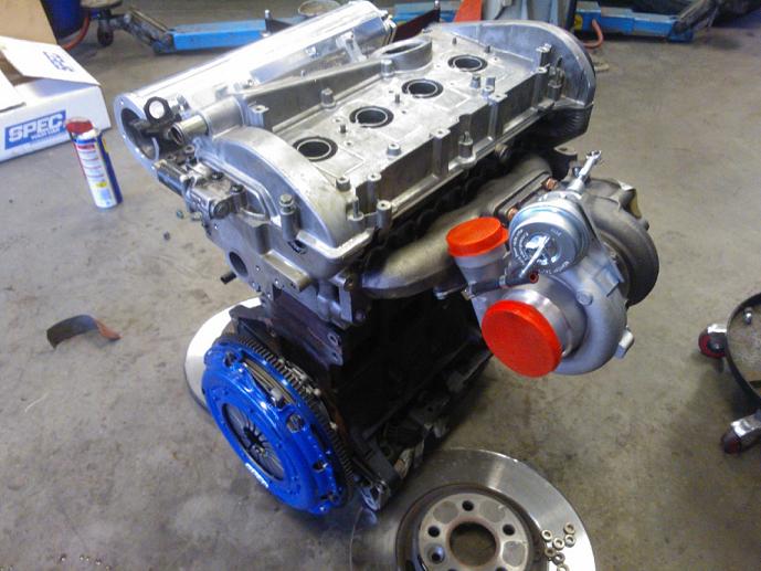

Engine Spec
Big Port cyl head
Uppgrade Intake
GT2871R Turbo

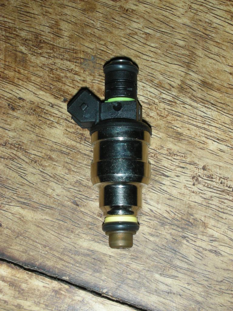

650CC (F1-Motor) inector

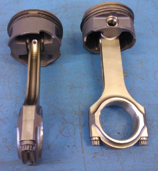

H-Profile rods (F1-Motor)
Supertech pistons +2,5mm
8,5:1 comp
Performance downpipe
Full Flow exhaust system
Working on the Software so the dyno run is coming
Chassis work
Stage2 clutch
Light solid flywheel
Big Intercooler
Stock valv
Stock Kam

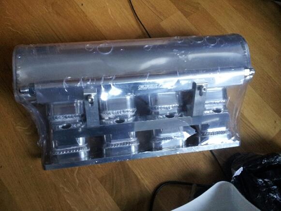

- The intake
