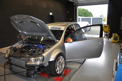

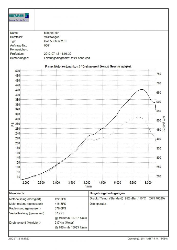

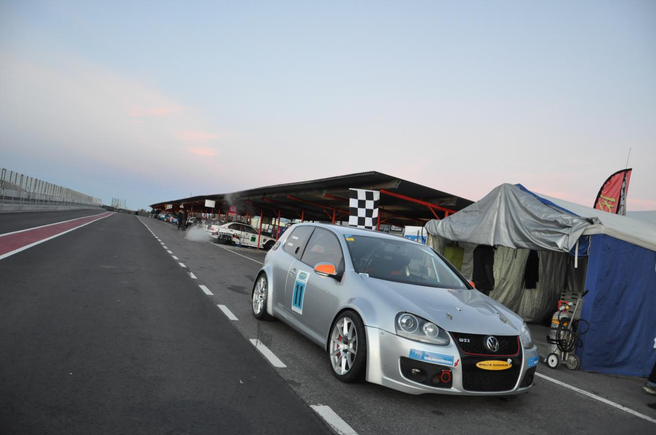

Golf R V 2,0 TFSI VW motorsport build Engine from F1-Motor
2,0 TFSI
422Hp at 5800Rpm
+500Nm

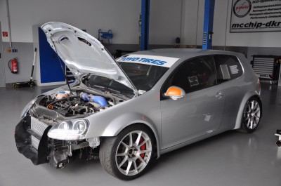

This whinter we install a new turbo, after get som problem with the studs and nuts get lose on the turbo.
Its my own design and we are what fore that so i post the result after the test at the dyno.
Allso its a new HPPF on the way and the new PCV system and some small things.

To day is a APR HPFP
And i dont like that one i have test a difrent one not Autotech,
and rail valve we are change allos bekures the ome are crack iff you go to highe fuel pressure.

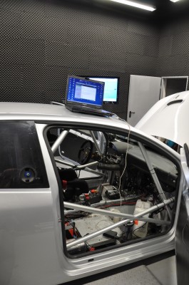

The dyno run is form we was in Germany at my friend

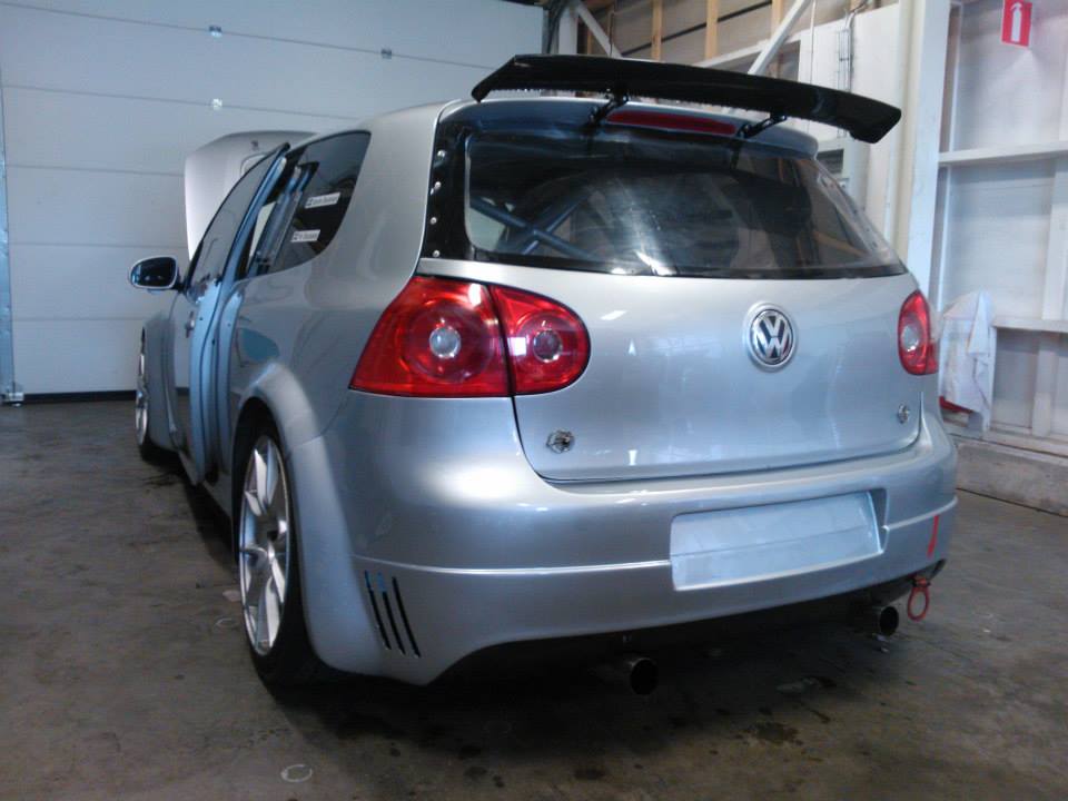

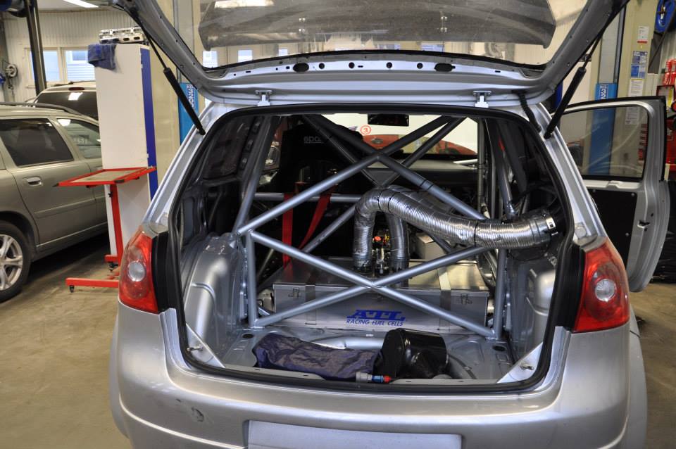

More Spec
Carbon fiber
Doors
Fenders
Bonnet front end rear
Seat motorsport brakes
air jacks
full flow brakes
120L fule tank
fast filling
The car was build fore Nyburgring 24/h and was winning with Kristofersson whin is was new from VW motorsport
It was 4 simmular cars build but this on is the first and lite diffrent from the rest

Engine spec
The block with cylinder head is Stock S3
The piston end the rods are +- 0,5 gram
Crankshaft ballans and strait
Cylinder head match the port fore intake and exhaust only.
Turbo Garrett GT2871R
Castiron exhaust manifold
Exhaust is build fore max 95db
at race we have get only 94.5db
3" downpipe
race 100 CC cat
3" exhaust to last end only muffler
Upgrade injectors from VW motorsport
1.5- 1.55 bar boost

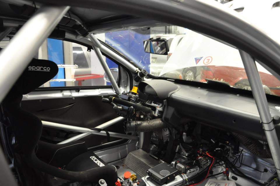

Some more photos

What a beast 8-)

Indlæg af RIX » 26. okt 2013, 20:09
kunne du evt. lægge moment kurven op???
