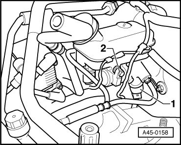

Jeg brugte 9 sekunder på Google og fandt dette:
Removing and installing components of the ABS/ESP system, ITT Mark 60
Removing and installing brake pressure sender -G201- from brake master
cylinder
Additionally required information
◆ VAS 5051 vehicle diagnostic, testing and information system
Removing
‒ Note radio code on vehicles with coded radio; if necessary ask for it.
‒ Disconnect and remove battery.
‒ Lay out plenty of lint-free cloths in the area of the engine and gearbox.
‒ Draw off as much brake fluid as possible from brake fluid reservoir using an extraction bottle.
‒ Fit bleeder hose and bleeder bottle to the front left brake caliper bleeder screw and open bleeder screw.
‒ Operate the brake pedal at least 15 times so that the brake master cylinder is emptied.
‒ Close front left bleeder screw.
‒ → Unplug connector -arrow- on the
relevant brake pressure sender to be
removed.
a - Sender for brake pressure in
pushrod piston circuit
‒ Remove sender for brake pressure.
Installing
‒ Install in reverse order.
‒ Bleed brake system
‒ Initiate basic setting
‒ Perform basic setting in "Guided faultfinding"
using VAS 5051.
Du skal bruge en VCDS efter de mekaniske er klaret til grundindstillingerne.

- g201jpg.jpg (35.73 KiB) Vist 2131 gange

jeg har ikke sådan en føler på min hovedcylinder som ses på tegningen men har ledt på nettet. Kan det passe at g 201 bremsetryksensor sidder i bremsepedalen og har 3b0 945 511a

Re: Hjælp til kode
